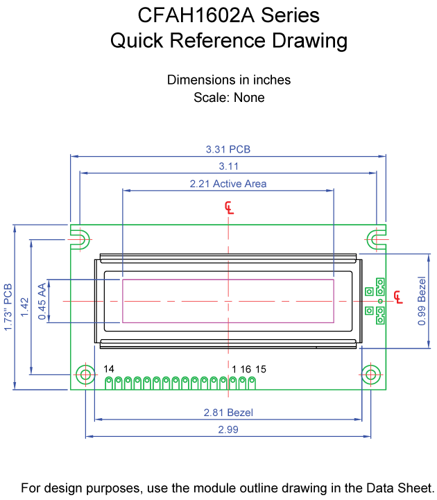

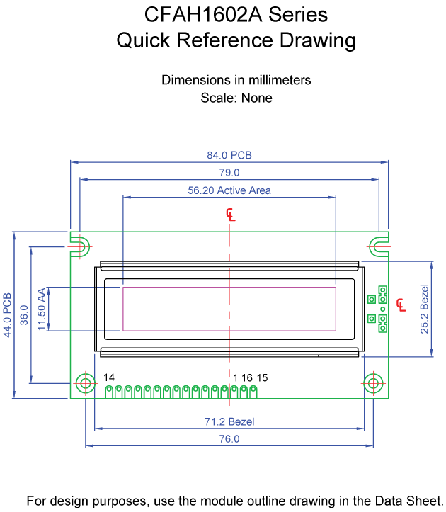

Back view
CFAH1602A-RGH-JT
Features:
Dimensions:
Documents:
1 to 1 Template (46KB)
Metric Scale Drawing (25KB)
Inches Scale Drawing (24KB)
